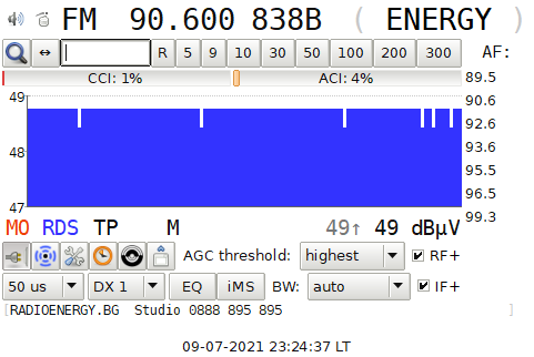

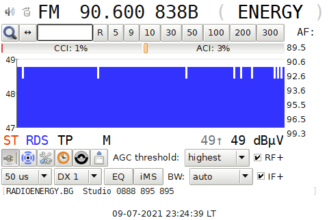

Now in TEF-GTK appear MO for mono and ST for stereo. Click on stereo indicator with right mouse button to force mono reception !
Download here: https://github.com/marsel90-1/TEF6686_Arduino_Radio
